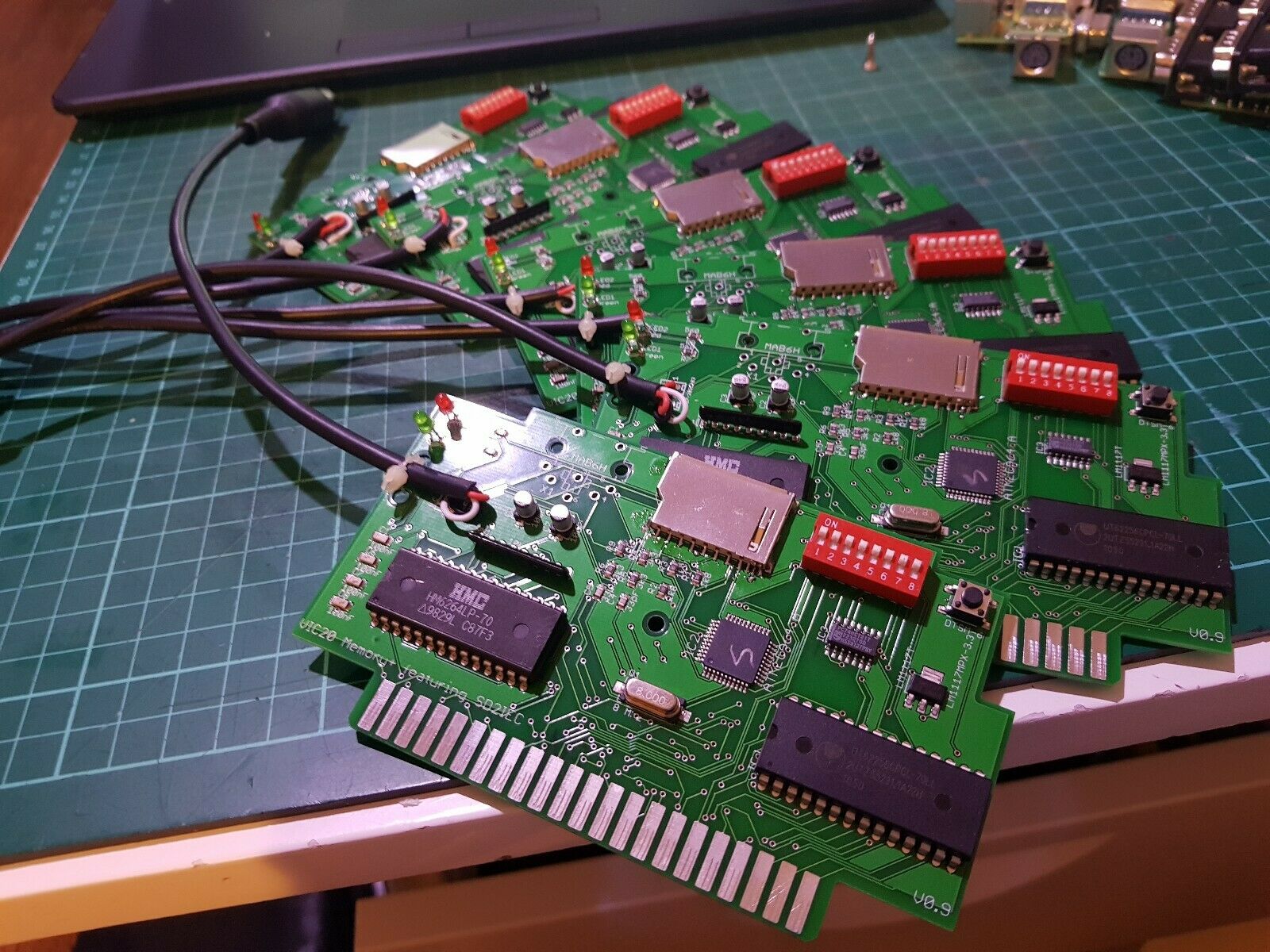

I notice none of the pictures show the board of this expansion or the connector.
If you look at all the cartridges Commodore ever sold for the VIC-20, the edge connector is gold plated. There are multiple reasons for that.
Also, there are tell tale signs if a PCB was designed by people who really know what they are doing or a basement tinkerer who thinks he's going to make a quick buck. Same goes for the quality of build/assembly and solders.
Hiding all these details seem suspicious.

Obviously no gold plating at all and a well scraped edge connector just doing the basic tests on this thing.
IMHO, steer clear!

It looks to be a well put-together board, but why are gold-plated connectors more durable?
I'm sure it's been explained before, but are newly-designed carts like this inferior to old/classic carts, when it comes to the edge-connectors?

mingle wrote:It looks to be a well put-together board, but why are gold-plated connectors more durable?
Ordinary PCB solderable surface is designed to solder parts, not insert/eject a board. The soft metal scrapes off when you insert/remove a board in the connector. It's not just VIC-20, it's the same for all modern PCs cards.
Gold is the best material you can use but it's not the only solution to this problem. In fact, most gold plated cards have a rather low grade of gold like 14 carats or less.
Yes, considerably so. Looking at my various VIC-20 carts, games and RAM expansions made by Commodore, it's obvious the edge connector on the RAM expansion is much better quality but even game carts have the minimum grade gold plating. It only gets slightly covered in dark carbon deposits after many uses and this can be removed easily with a simple white 'plastic' pencil eraser.
If you look at the edge connector of any video card or whatever type of PCIe card available today in a computer shop, they all have gold plating.
Every single Behr-Bonnz multicart I have ever sold and all the Ultimate Expanders I made and sold have hard gold plating on the edge connector except for the very first 2 prototypes.
