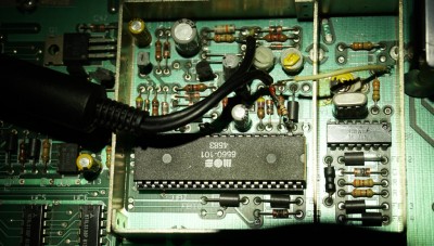

Since none of my VIC-20s suffer this problem, I had a much easier solution. Lift pin 2 of the VIC-I from the socket, solder a 0.1uF capacitor to it in series with a 360 ohms resistor. There is your chroma signal.
Since you've now effectively turned your VIC-20 monochrome on the normal video port, you take the luma+sync signal from there.
If you don't understand by sifting through the text above, don't worry, I won't react with inflammatory comments. I'll just post a photo and that will save everyone a few thousands of words.

joshuadenmark wrote:Yes please
At your service...
There are 3 attachment points in the image above.
1. The white wire is the easiest connection to the ground I could solder - the nearest point was too tight for the soldering iron to get in and many other places had no thermal relief so that's the best compromise I could find
2. The luma+sync is connected to the output of the video amplifier with LC filter
3. The chroma is attached directly to pin 2 of the 6560 via a 360 Ohms resistor in series with a 1206 SMT capacitor of 0.1 uF.
