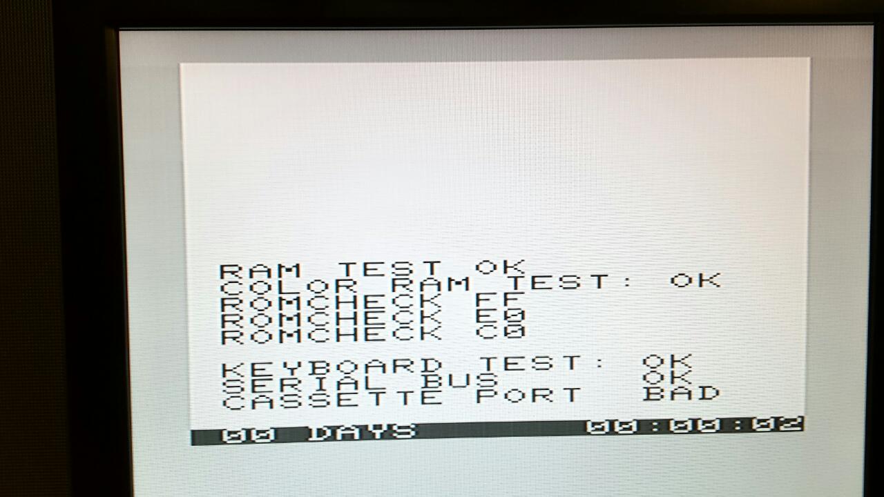

Today I am testing vicist's vic20s.
1st one seems to have a bad via. vicist reports:
vicist wrote:
Star Battle crashes on loading from SD2IEC.
Image Image
Download here
ftp://www.zimmers.net/pub/cbm/vic20/rom ... Battle.prg

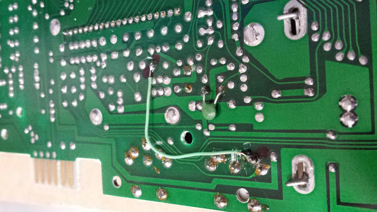

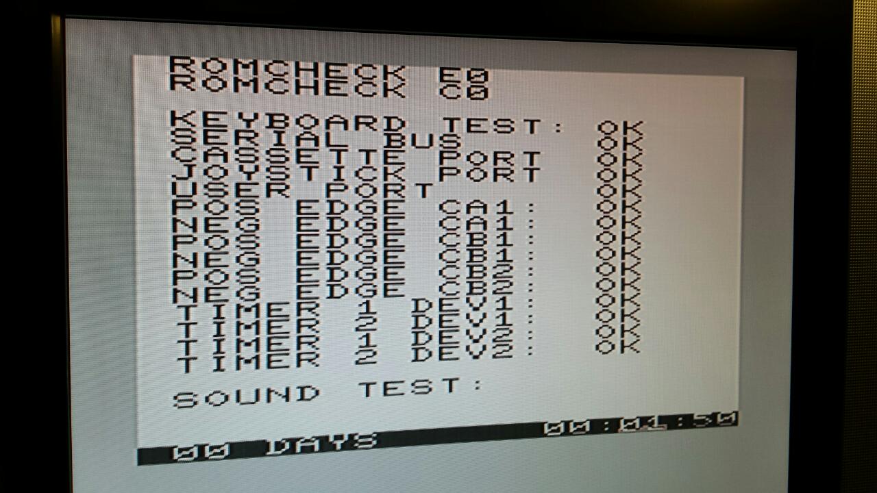

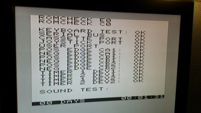

2nd one passes tests. But has colour issues (yes I know I don't have the correct cable for s-video mod).
mrr19121970
Posts: 885
Re: repairs for vicist
Post by mrr19121970 »

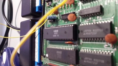

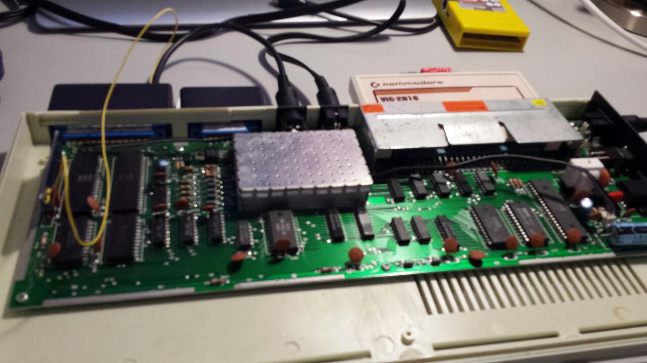

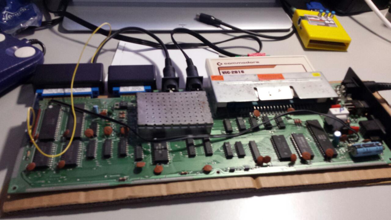

Both machines have s-video mod wire replaced.
Machine 1 has vic-I socketed.
Machine 2 has via2 socketed and replaced. Now passed test.

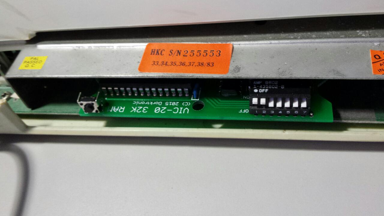

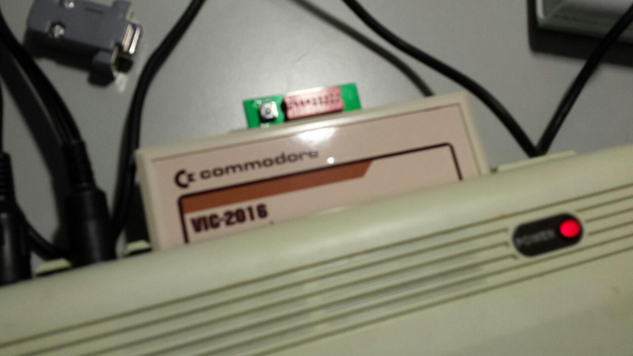

We need k3ys opinion here. I can't get star battle to load either with his card. Works fine with Penultimate card and sd2iec. I can't get it to run with @k3ys expander.

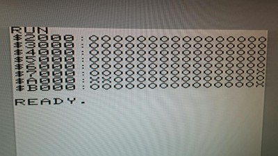

I am getting X showing memory errors when running his 'TESTING MEMORY' basic program

I just checked my cart against yours. Try flicking dip switch 7 up as this is the config that I have. May make a difference. Who knows?

Try the memory test again now that 7 is up and see what you get.

vicist wrote:Try the memory test again now that 7 is up and see what you get.
Well switch 7 is for ram 1-3 are 0400 to 0fff. Only switch 6 needs to be down to activate bank $a0

My ram doesn't have the extra 3k.

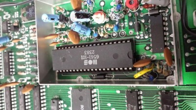

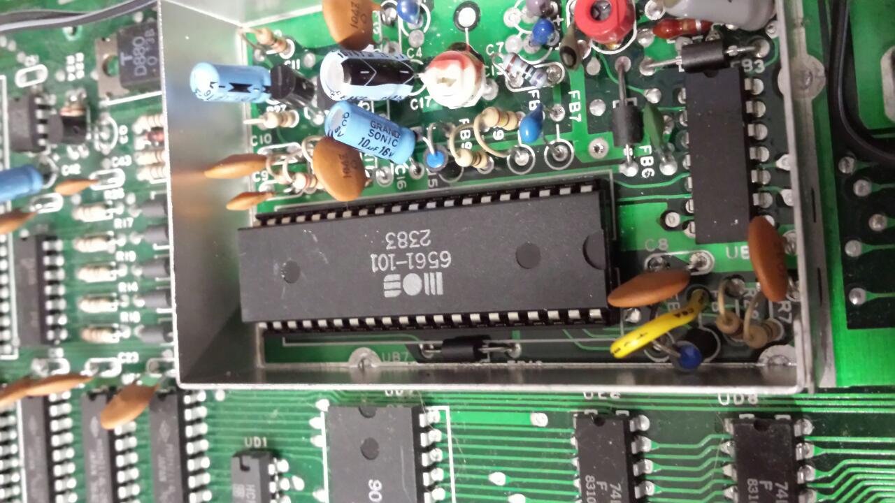

I desolder the VIC-I from machine #2 and put it in machine #1.
DONE

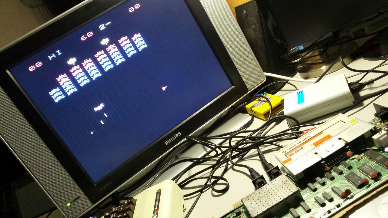

GORF is working with multicolour again and STAR BATTLE still works with @k3ys expander
Update
I am 100% sure this is an @k3ys issue. I am now using a VIC1110 with the 8k @ $a0000 - guess what STAR BATTLE works fine on the 'broken machine'
On my VIC20, also I have the same issue with the @k3ys expander

In the picture showing the 'memory test pattern', it is indicating a problem with $a000 memory.
I tested my ram in all my machines and always got a 'clean' result.
I assume you have tried it with just block 5 active?
