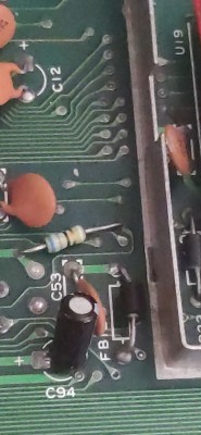

I think I figured out where R42 is positioned. I just can't figure out where & C204...
Here's a picture of the board. Do you have any ideas where to look?
I also noticed that this board looks like it has had some components added on ad-hoc...

banman wrote: Wed Jun 17, 2020 11:40 pm I think I figured out where R42 is positioned. I just can't figure out where & C204...
According to the schematics, the presence/absence of C203 and C204 depend on the type of PLA installed as in 1983, Commodore had the old 82S100 based ones and the newer ones (aka 7700-01) made by their own fab (the ones with the bad chemicals which would self destroy) and a 3rd party model called MB112A101.
See: http://www.zimmers.net/anonftp/pub/cbm/ ... 8-1of2.gif
Look at the table in the lower right corner which indicates the presence/absence of C203/C204 depending on the type of PLA installed.
PLAnkton being based on the response speed of the slowest type, it requires neither C203 or C204 but will work fine with any of the 2 installed. Only one of the 2 can be present.

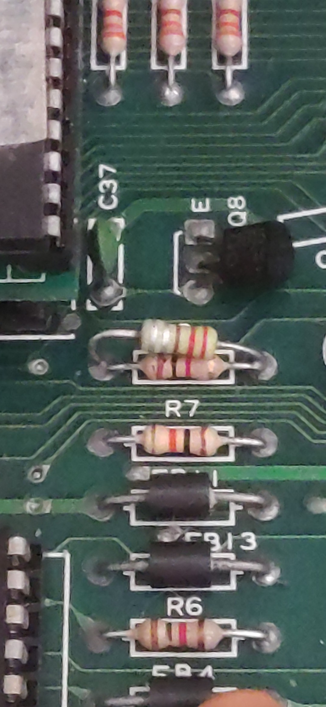

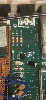

Hi eslapion,
Here is were the 2 components are positioned on the board.

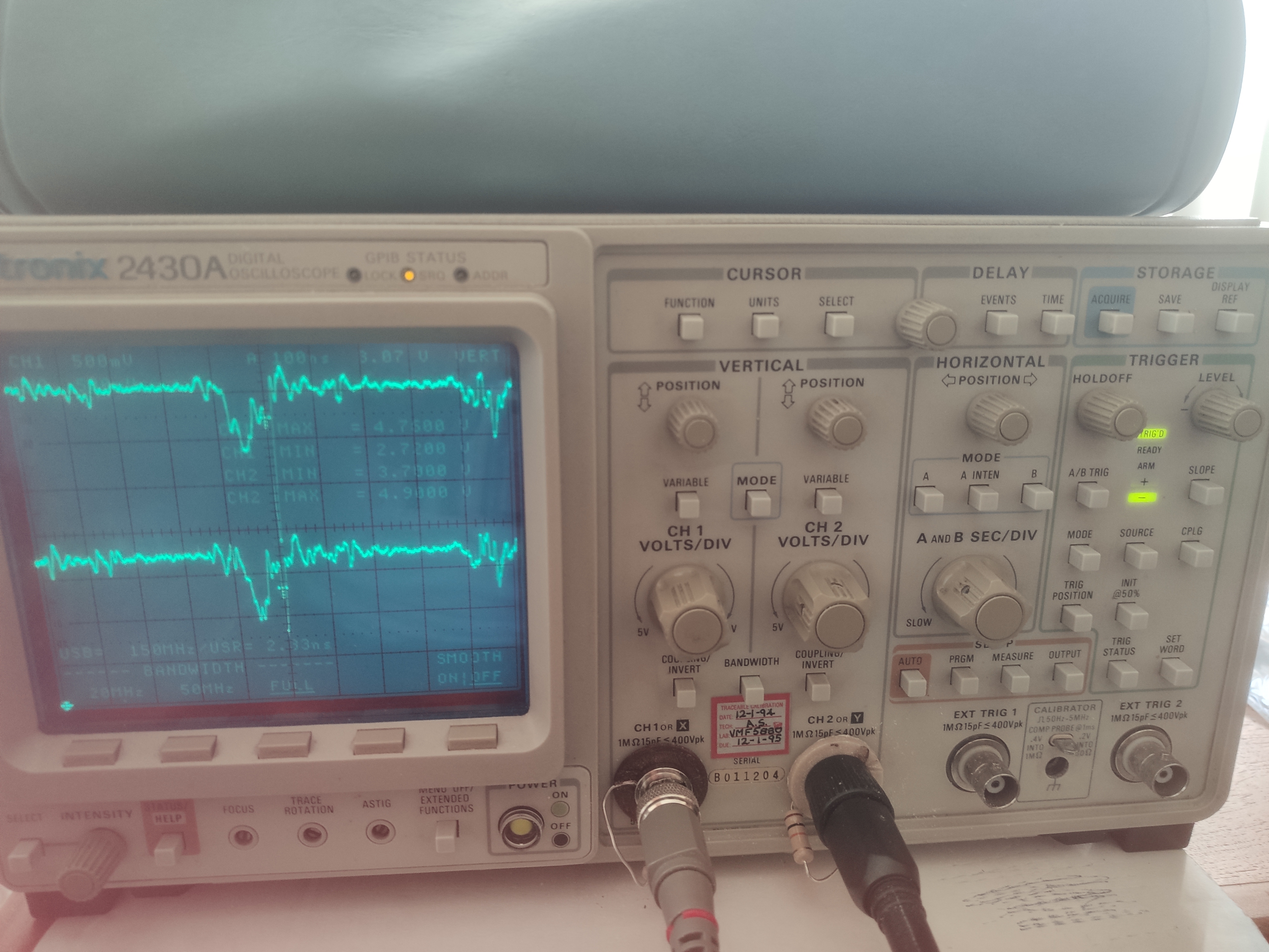

I managed to observe a simultaneous glitch on pin10 (!ROMH) & pin 11 (!ROML) using the dodgy Winbond PLA substitute PLA on a 250407 'hipric' mainboard.
What is the ! for in !ROMH & !ROML?
I understand my equipment isn't the greatest and my skills even more so.
I notice both traces dip at the same time. I wasn't getting the best readings. I will try harder to get a clearer reading.
If these two pins are signalling towards zero volts simultaneously would it be fair to say that hypothetically this could potentially cause chips to be called up on the mainboard's bus together - a Bus Contention? What are the problems with a Bus Contention?
Correct. The convention used in Commodore 8 bit computers, TTL levels, indicate a low logic level is signaled when below 1.5V. If more than one outputs of the PLA go below 1.5V then more than one device was flagged active on the bus and a bus contention may have occurred if this flagging lasted long enough for the devices to become active on the bus.
Since older memory chips require a longer period of flagging before they start signaling on the bus then simultaneous flagging of multiple devices lasting 50ns or less are not likely to result in bus contentions if you have all the original (slow and old) chips in your C64. However, if you installed a brand new JiffyDOS module which happens to use fast 45ns EPROMS then there is a greater chance of having a bus contention between it and something else.
Looking at your scope captures, the lowest voltage captured was 2.72 volts so technically these glitches did not cause flagging of more than one device to be active on the bus and no bus contentions occurred.
The multiple devices which have been flagged active enter a sort of tug of war on the bus. These can get damaged or destroyed. If these contentions are short in duration, they may simply consume more power and dissipate more heat.

Thank you for the clarification on the meaning of. ! & / In regards to !ROMH & !ROML. I have seen it in documents like you described but didn't get the connection.
I think in the last photo of my previous post the low voltage on probe A (!ROMH) got to 1.9V.
It was a bit tricky Tring to get the best photos to post.
Shortly after I managed to get a video of probe A triggering at 1.5V. I muffed it up though. I didn't set probe B to 500mV as it was for probe A . I think probe B was at 5V.
The oscilloscope was going as hard as it could. I am sure there must be glitches that aren't being detected due to the limitations of this machine.

banman wrote: Fri Jun 19, 2020 6:22 am I think in the last photo of my previous post the low voltage on probe A (!ROMH) got to 1.9V.
Correct.
Don't get me wrong the oscilloscope gas been a great tool. It has been an incredible opportunity to see something and meet interesting people who have given me a glimpse of a dimly perceived thing I couldn't explain.
The setting on that last photo was 100ns per division. Could you have increased resolution to 40ns/div ?
