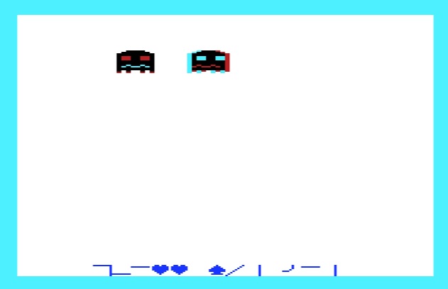

Dear all,
during the easter brake i had a little time to play around with the SoftwareSpriteStack API from Robert.
But, If i move a sprite in horizontal direction i get some glitches on the sprite.
Is there another call i have to do it before i draw the sprite?
Left, the sprite without movement.
On the right side after a horizontal movement.
Best regards
Sven
Best regards
Sven
DEMO7 LDA #$1B
STA $900F
LDA #%10001111 ; 16x16 sprite floats X-Y and uses Ghosting (bit 5)
LDY #$10 ; height
JSR SSSCREATE
LDA #$0a ; red
LDX #<cBIGRED1 ;create a new sprite coloured red
LDY #>CBIGRED1
;LDX #<BITMAP ;create a new sprite coloured red
;LDY #>BITMAP
JSR SSSANIM
LDX #0 ;X position for sprite
LDA SSSCLIPY ;use Y clip value to form Y position for sprite
LSR
TAY
JSR SSSMOVEXY
LDX #30
STX SPRITEX
STX SPRITEY
loopd8 LDX #0
JSR SSSUSE
lda #%01111111
sta $9122 ;Set Data Direction of port B to READ (0=read)
lda $9120 ;Port B (R------- Switch)
sta R0;z_as
lda $911F ;Port A (--FLDU-- Switches)
rol R0;z_as
rol
sta R1;z_h ;-FLDU--R
lda R1;z_h
cmp #%11111111
beq JoyNotRight;loopd8 ;See if no keys are pressed
sta R1;z_h
and #%00001000 ;-FLDU--R
bne JoyNotUp ;Jump if UP not presesd
dec SPRITEY ;Move Y Up the screen
JoyNotUp
lda R1;z_h
and #%00010000 ;-FLDU--R
bne JoyNotDown ;Jump if DOWN not presesd
inc SPRITEY ;Move Y Down the screen
JoyNotDown
lda R1;z_h
and #%00100000 ;-FLDU--R
bne JoyNotLeft ;Move X Left
dec SPRITEX
JoyNotLeft
lda R1;z_h
and #%00000001 ;-FLDU--R
bne JoyNotRight ;Move X Right
inc SPRITEX
JoyNotRight
LDX SPRITEX
LDY SPRITEY
JSR SSSMOVEXY ;move the BigRed sprite across the screen
JSR ANYKEY ;until a key press
BEQ loopd8

If they're multicolour you have to move in increments of 2 on the horizontal otherwise you are changing the bit pairs (that make the colour of a pixel) between odd and even x positions. I can't remember if SSS has any attribute or flag to handle multicolour specifically, but that is what it looks like from your screenshot.

AndyH is exactly right. Look at the demo I've just posted and on the Repeat Sprites screen you will see the multicolour sprites moving twice as fast as the single colour sprites. That is because I increment the X parameter by 2 at each update of the multicolour sprites and by 1 for the single colour sprites.
There is no automation of this in the SSS. It is the programer's responibility to keep the multicolour sprites on an even value in the X coordinate.

Is it theoratically possible to move multicolored sprites by one pixel?
thank you for the answer.

Short answer is no.
You could attempt to create 8 pre shifted images in multicolour to give the impression of moving 8 steps, but your pixels will still be fat (double witdth) and restricted to the one of four colours available in the character cell, while bit 3 is set in the corresponding colour memory cell. So this is just animation and still falls under the rules of how multicolour is achieved.
Another simpler thing you can do is store the x position outside of sss and when you pass it in mask out (clear) bit 0 so the sprite routine is always positioned on on even boundary but your actual x position can be odd and even values. Your sprite will still move on the multicolour 2 pixel boundaries but you'll avoid the colour changes you observed and the time it takes to move horizontally will be consistent if it was moving 1 pixel at a time.
