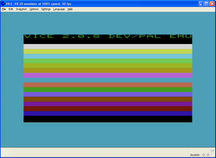

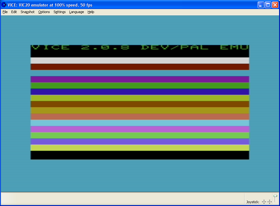

It would be useful if some of you had the possibility of posting screen-captures (screen grabber is prefered) of the program below.
Please change the PRINT in the first line to identify your machine. VIC20/VIC20CR/PAL/NTSC (and VIC chip information if possible)
I've made a small test program here: palette_bas.prg
As type-in:
 10 PRINT"{clr}{grn}<INSERT DESCRIPTION>"
 20 A=828
 30 READB:IFB<0THENSYS828
 40 POKEA,B:A=A+1:GOTO30
100 DATA 120,162,17,169,11,172,1,144,200,200,200,200,200,204
110 DATA 4,144,208,251,141,15,144,105,15,202,208,238,240,229
120 DATA -1
It is especially interesting to see if there is a difference between the VIC20 and VIC20CR. For PAL I believe those use the 6561E and 6561-101 respectively.
This is what it looks like in vice:

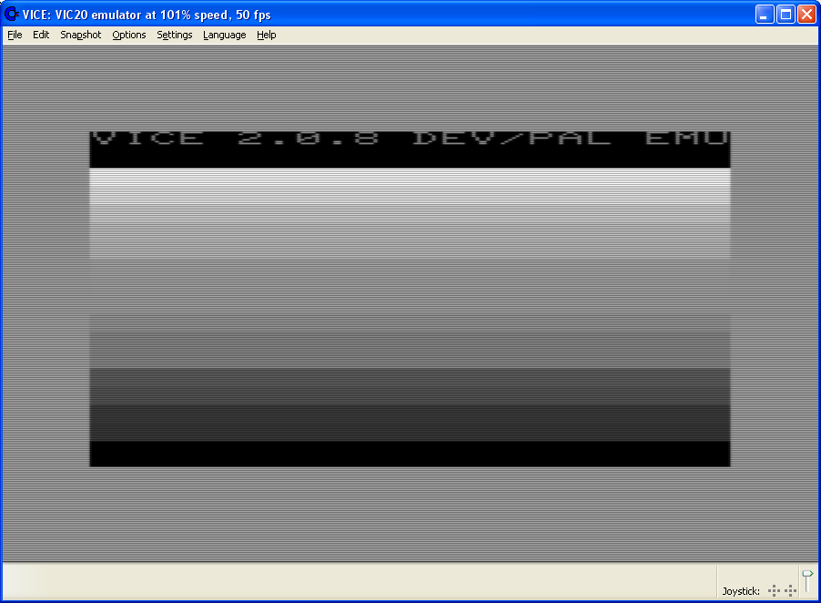

I've made a new program, more suitable for ocular comparison.
It displays all 16 colors sorted according to expected luminance. As you can see some luminances are nearly the same.
Run this on your vic20, turn down the color knob to minimum (i.e bw), and compare to the bw screen shot below.
I can confirm that the luminances on my VIC20 (two-prong, 6561E 4881) are nearly identical to the ones below.
Test program here: palette2_bas.prg
As type-in:
 20 A=828
110 DATA 4,144,208,251,141,15,144,189,87,3,202,208,237,240
120 DATA 228,11,107,43,75,139,235,91,171,59,203,155,123,219
130 DATA 187,251,27
140 DATA -1
For the curious: the colors displayed are (top to bottom): 1, 15, 11, 13, 7, 9, 12, 3, 10, 5, 14, 8, 4, 2, 6, 0
This is what it looks like in vice with saturation 0.0:
This is what it looks like in vice with saturation 1.0 (normal setting):
