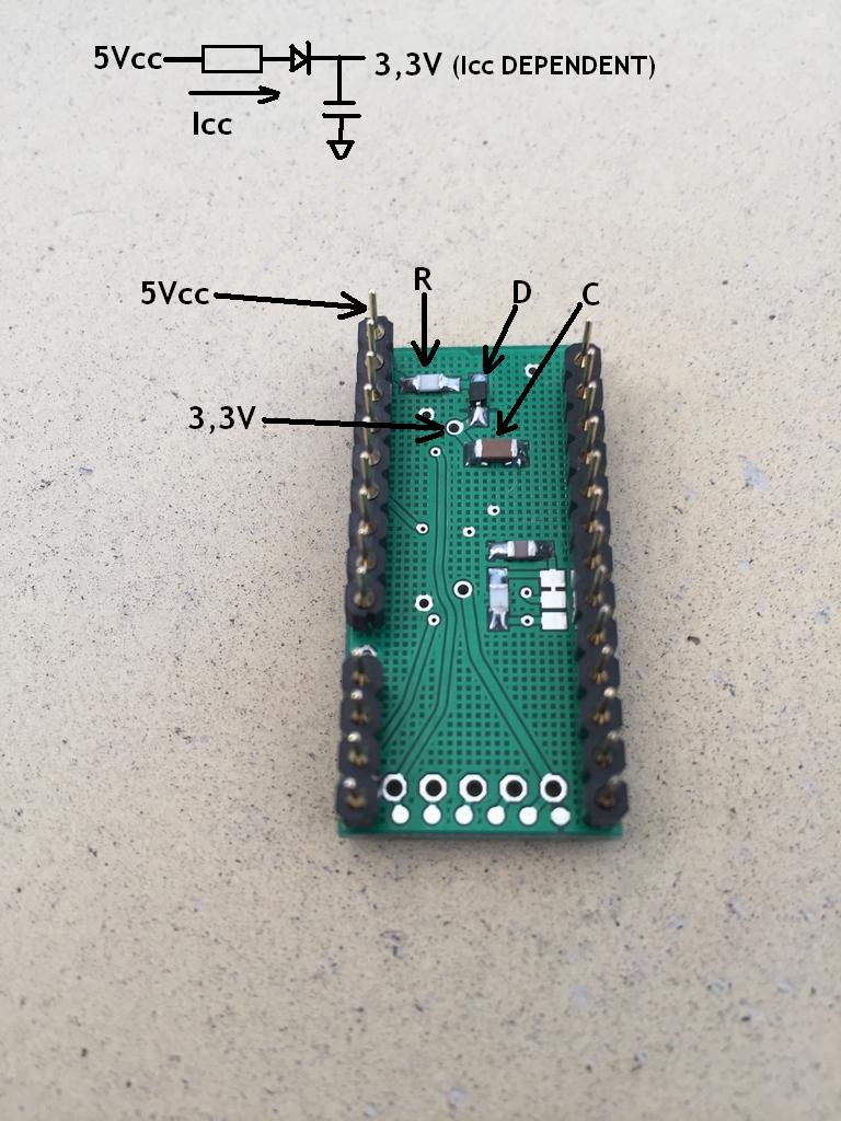

PLAnkton is not supposed to operate at 3.3V... perhaps a bit of circuit analysis would help you figure it out...MCes wrote:hey boss,

To ensure compatibility with the C64 Reloaded MK1 which has a few 74HCxx logic circuits as well as all C64 which may have been repaired with this type of chips, the XC9536XL on PLAnkton operates at 3.6V, NOT 3.3. While 74LS ICs used by Commodore have a logic threashold of 1.3V, 74HC logic circuits have a logic threshold of 2.5V but most manufacturers recommend signaling a logic 1 at 3.5V or more for these chips.

I took this decision based on the fact Skoe noted real PLAs signal 0-3.7v so 3.6V is extremely close. Here: http://www.zimmers.net/anonftp/pub/cbm/ ... sected.pdf
I also note since the particular unit has the resistors turned upside down, it was built by e5frog.
The components you mentioned act as an RC filter which has a cut-off frequency of 1/(2*3.14159265*27*1e-6)=5900hz. That's low enough to remove any junk from the power supply or noise caused by other components in the C64. It provides 10 times the recommended decoupling.
The voltage drop of the resistor and diode is 0.022mAx27Ohms+0.75v=1.344v. Then 5V-1.344=3.656, a tad above the recommended 3.6v but well below the absolute maximum rating of 4.0v.

BTW, this was extensively discussed on Melon64. It's because of the components you just mentioned that it is virtually impossible to distinguish the output of PLAnkton vs a genuine Commodore PLA. It also makes it extremely easy to check for defects as a faulty unit with a short will consume more current and the voltage at the CPLD will drop.
Would you like oscilloscope captures of the voltage at the CPLD Vcc/GND as well as those of the current consumption ? I am dying to use my recently purchased TDS3014B...
