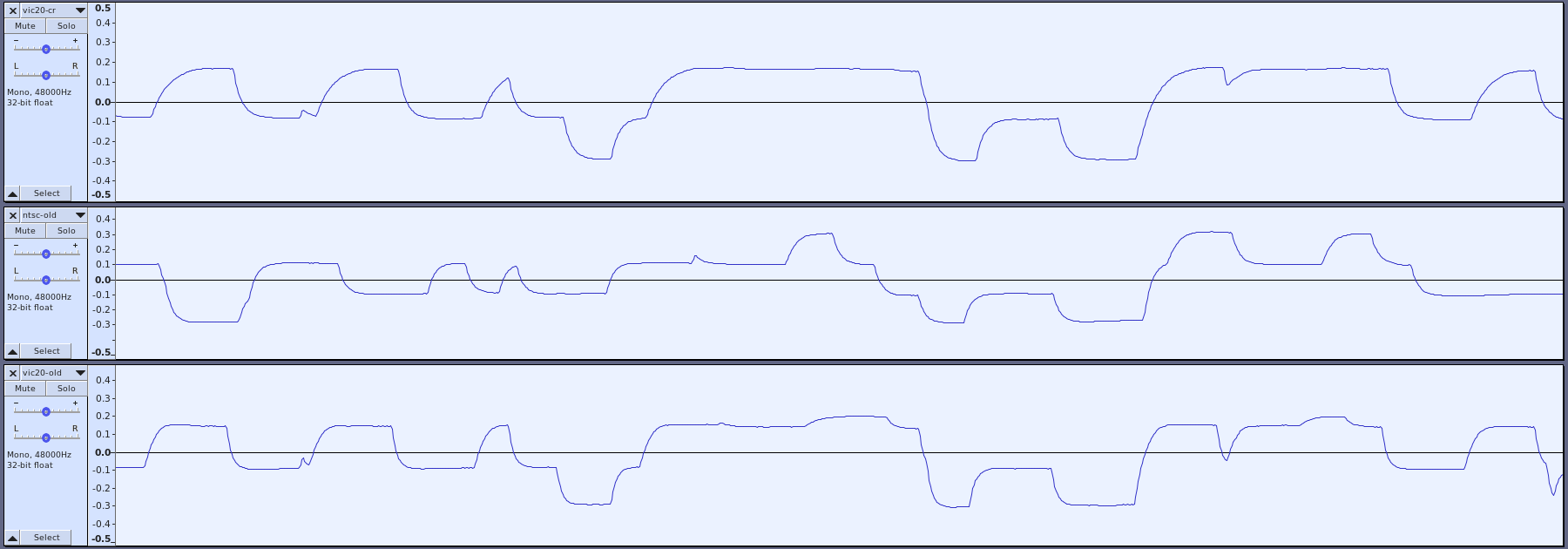

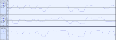

I did an audio capture of the high score music.
Here are 3 waveforms from the same sample from different VIC20s (VIC20 CR model, NTSC 'old' (2-prong power), PAL old.)
The NTSC old model is the clear winner here with 4 distinguishable levels corresponding to 3 voices. The other models all sound slightly to horribly distorted.
Audio clipping could be due to the VIC chip itself or the amplifier circuit on the board.
