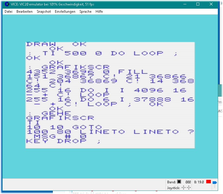

Hi good afternoon.
thank you for your help.
how is goto and lineto recognized now?
MSG # 19 ist the error.
greeting
greeting

Re: V-FORTH - Forth-83 for the VIC
If you are going to call plot directly you will have to define lineto after it and change
to just be
lastx @ lasty @ plot @ execute ( plot point )
lastx @ lasty @ plot ( plot point )
Hi good afternoon.
thanks for your vforth 1.4.1.
thanks for your lineto.
I don't know how to get lineto up and running.
can you please, please put it in the below of my program without "definitions ...?.
just in there to make it work.
Thank you.
greeting
Thank you.
greeting
Add this immediately before grafikscr
variable lastx
0 lastx !
variable lasty
0 lasty !
variable x1
variable y1
variable dx
variable dy
variable sx
variable sy
variable err
: goto ( x y -- )
lasty ! lastx ! ;
: lineto ( x y -- )
y1 ! x1 !
x1 @ lastx @ - abs dx !
lastx @ x1 @ < if 1 else -1 then sx !
y1 @ lasty @ - abs dy !
lasty @ y1 @ < if 1 else -1 then sy !
dx @ dy @ > if dx @ else dy @ negate then 2/ err !
begin
lastx @ x1 @ xor lasty @ y1 @ xor or while
err @ dup dx @ negate > if dy @ negate err +! sx @ lastx +! then
dy @ < if dx @ err +! sy @ lasty +! then
repeat ;
is not possible yet.
now I did it once as you intended
With :
vocabulary draw immediate
draw definitions
Thank you.
greeting
With :
draw definitions
Thank you.
greeting

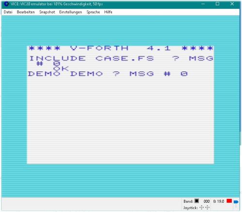

Hi good afternoon.
how does vforth work:
"case, endcase, of, endof" please
can you please create an example?
Thank you.
greeting
Thank you.
greeting
I've not included an implementation of case mainly due to space. There are many different definitions the simplest from Forth Dimensions V2N3 is this
: case
?comp csp @ !csp 4 ; immediate
: of
4 ?pairs compile over compile = compile ?branch here 0 ,
compile drop 5 ; immediate
: endof
5 ?pairs compile branch here 0 , swap 2 [compile] then
4 ; immediate
: endcase
4 ?pairs compile drop begin sp@ csp @ = 0= while
2 [compile] then repeat csp ! ; immediate
: demo
begin
key
case
65 of ." a" endof
66 of ." b" endof
67 of ." c" endof
endcase
?terminal until ;

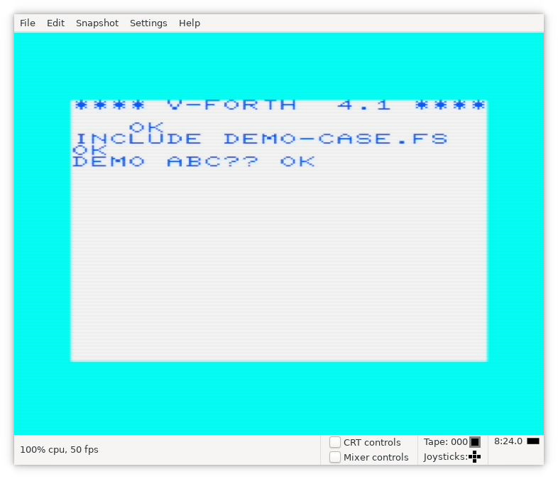

Hello, thanks for your help.
but it doesn't work.
Thank you.
greeting
Thank you.
greeting
You're again having some encoding issues, I cut-and-pasted that from a file that I tested.
- demo-case.zip
- (409 Bytes) Downloaded 307 times
