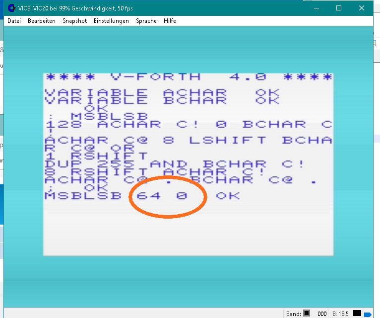

it comes out a wrong value at bchar.
thanks.
greeting
variable achar
variable bchar
: msblsb
128 achar c! 0 bchar c!
achar c@ 8 lshift bchar c@ or
1 rshift
dup 255 and bchar c!
8 rshift achar c!
achar c@ . bchar c@ . ;
Re: V-FORTH - Forth-83 for the VIC
You only have the top bit of achar set, try using 129 instead.

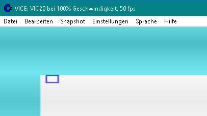

Hi good afternoon.
I play with vforth.com in the Vic20
the first start with a sprite is done.
in "A" is the sprite and "B" is empty.
sprite wanders to the right and wanders to the left.
press button "A" 8 x sprite moves to the right
press button "B" 8 x sprite moves to the left.
greeting

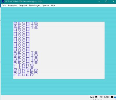

Hi good afternoon.
it breaks off with Joy. the joy works.
what is going on in the begin ... until?
why is the stack emty ?
i wrote something that works with the keys is ok .
begin
key setze ?terminal until ;
: setze
oyb @ 22 * oxb @ + pw ! 32 sw @ pw @ + c!
oyb @ 1 + 22 * oxb @ + pw ! 32 sw @ pw @ + c!
dup 81 = if xb @ 1 - xb ! then xb @ 0 < if 0 xb ! then
dup 69 = if xb @ 1 + xb ! then xb @ 21 > if 21 xb ! then
dup 87 = if yb @ 1 - yb ! then yb @ 0 < if 0 yb ! then
dup 83 = if yb @ 1 + yb ! then yb @ 21 > if 21 yb ! then
dup 82 = if fb @ 1 + fb ! then fb @ 7 > if 7 fb ! then
70 = if fb @ 1 - fb ! then fb @ 0 < if 0 fb ! then
thanks
greeting

joy is ok !!!!!!
variable test1
variable test2
variable test3
hex
: joy
1  9122  c@  dup  7f  and  9122  c!
9120  c@
swap  9122  c!
80  and  if  1-  then
9111  c@  >r  r@  10  and  0=  if  drop  -1  then
0  r@  4  and  0=  if  1-  else  r@  8  and  0=  if  1+  then  then
1  r>  20  and  if  1-  then  ;
decimal
: gehe
begin
key drop joy test3 c! test2 c! test1 c! ?terminal
test1 c@ 255 = if ." links" cr then
test1 c@ 1 = if ." rechts" cr then
test2 c@ 255 = if ." hoch" cr then
test2 c@ 1 = if ." runter" cr then
test3 c@ 1 = if ." feuer" cr then
until  ;
