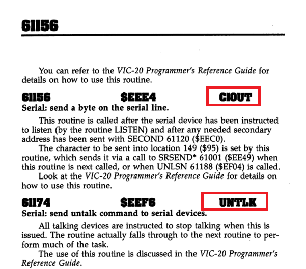

Can someone help me out? I am working on a new chart for user callable rom subroutines. I have found two different descriptions of the following memory location:
EEE4 (61156) CIOUT Send byte on serial line
and
EEE4 (61156) UNTLK Serial: send untalk command to serial devices
Can anyone help me rectify this or improve the description?

Jeff-20 wrote: Mon Apr 10, 2023 9:22 pm Can anyone help me rectify this or improve the description?
Hi there Jeffrey,
I've just print screened the page from mapping the VIC.
According to the book UNTLK starts at EEF6 and CIOUT starts at EEE4
Suggestion: 'Set serial byte to send' maybe?

My preference would be
EEE4 (61156) CIOUT Send byte on serial bus

huffelduff wrote: Tue Apr 11, 2023 10:29 am Suggestion: 'Set serial byte to send' maybe?
srowe wrote: Tue Apr 11, 2023 12:19 pm My preference would be
Thanks! This is all helpful.

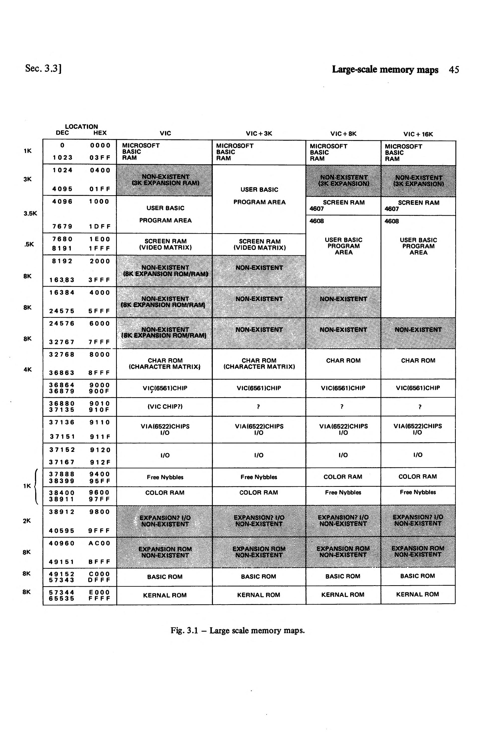

Most seemed to request the large scale memory map be in color, so I moved it to the interior front page (color printing for the cover).
Now I have a new issue. What colors should be used? For example, the image above from Mastering the VIC uses slightly varied shading as I did in earlier drafts. This may be a dumb question: Would specific colors have significant meanings to you?
Right now, I just picked arbitrary colors, but planned to revisit with input.

Jeff-20 wrote: Mon Apr 17, 2023 1:55 am Now I have a new issue. What colors should be used? For example, the image above from Mastering the VIC uses slightly varied shading as I did in earlier drafts. This may be a dumb question: Would specific colors have significant meanings to you?
For the diagram on page 46 I just chose colours that contrasted, there was no meaning to them.
