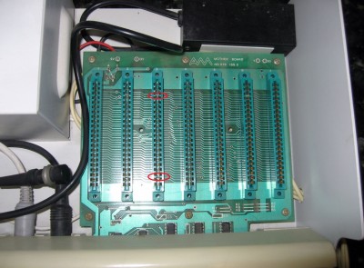

Heather, maybe for REV 12 you an e3frog can add the notches on the right (between 2nd and 3rd connectors) and left (3rd and 4th connectors) so that the FE3 can be used in the VIC1020 and other expanders with the 'directional protection' ?

I think doing that would be simple enough. I'll let you know. Do you happen to know the max size in mm that the space would have to be? Is it always centered between two connectors? When you say Left and Right, do you mean left and right looking at the cartridge with the card edge connector facing you?
