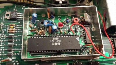

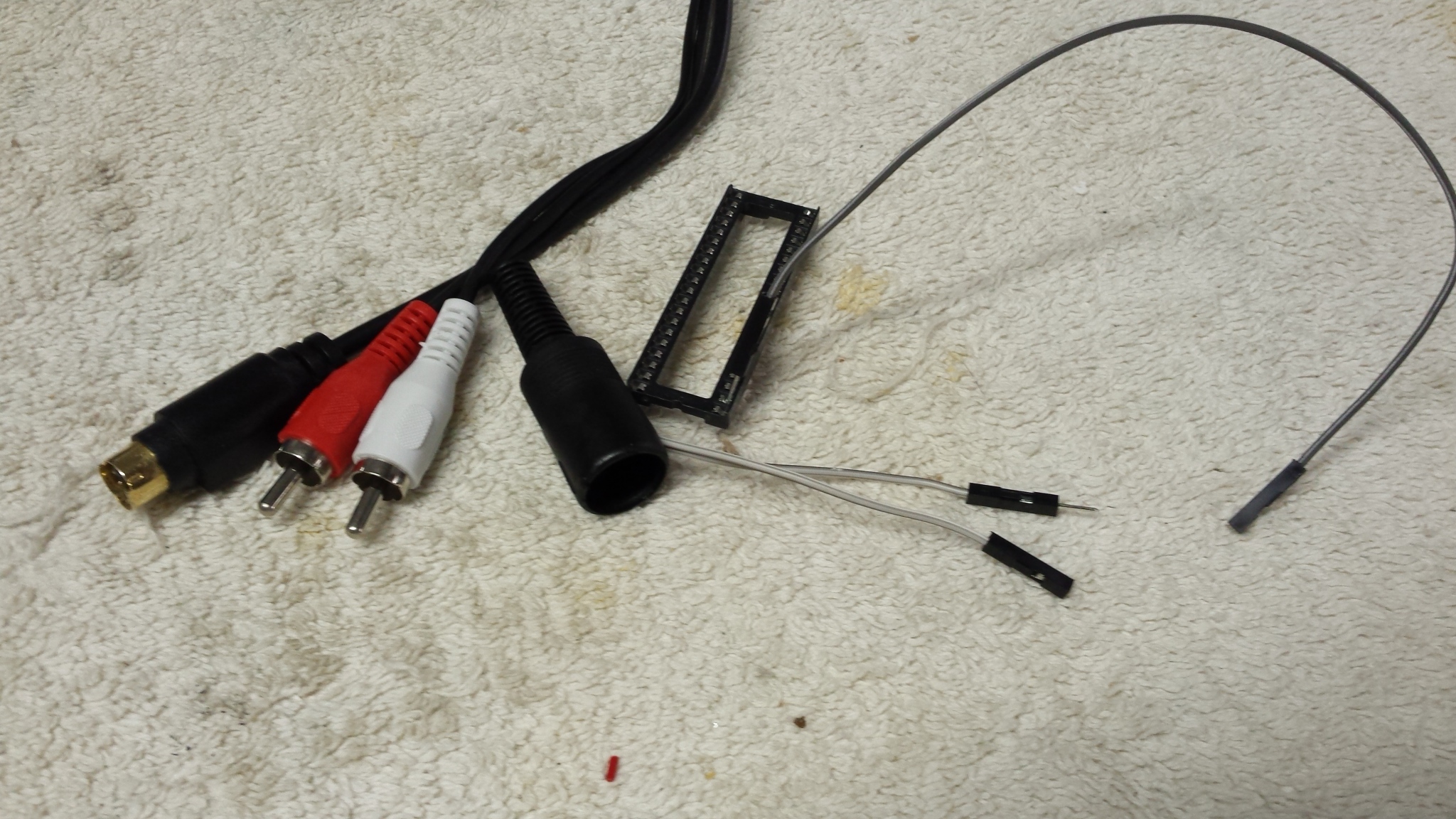

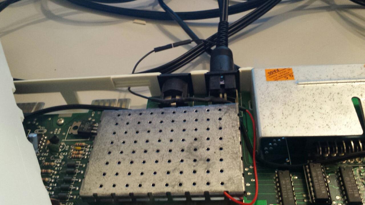

So not exactly as I planned it. But this is how it works. Removed your vic-i from the socket. Add the 2nd socket with you capacitor and resistor. Put the vic-i back in the socket. Little wire goes over the tin edge and between the fingers on the lid and out of the case. Here you join the chroma with a 1 pin dupont connector to the 5 pin connector.
To reverse simply pull the vic-I and the 2nd socket and put the vic-I back on the board. Same cable can be used for composite only.
Screen without mod (just composite) Screen with mod Mod
Socket with PIN#2 removed and modding wire soldered onto top. 0.1uF ceramic capacitor and 75 ohm resistor in series (insulated with heat shrink tubing) leading to a 1 PIN DuPont female connector outside the case (secured with cable tie on the eyelet next to the datasette edge connector) Modding wire comes over the top of the 'tin' and between the 'fingers of the lid' and around the tin so that the insulated capacitor and resistor are between the 'tin' and serial/video connectors. The standard 5 pin video wire is connected 2 GND, 3 audio and 4 luma. There is a male DuPont connector directly to the chroma

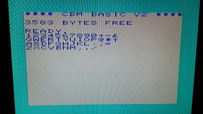

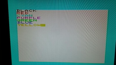

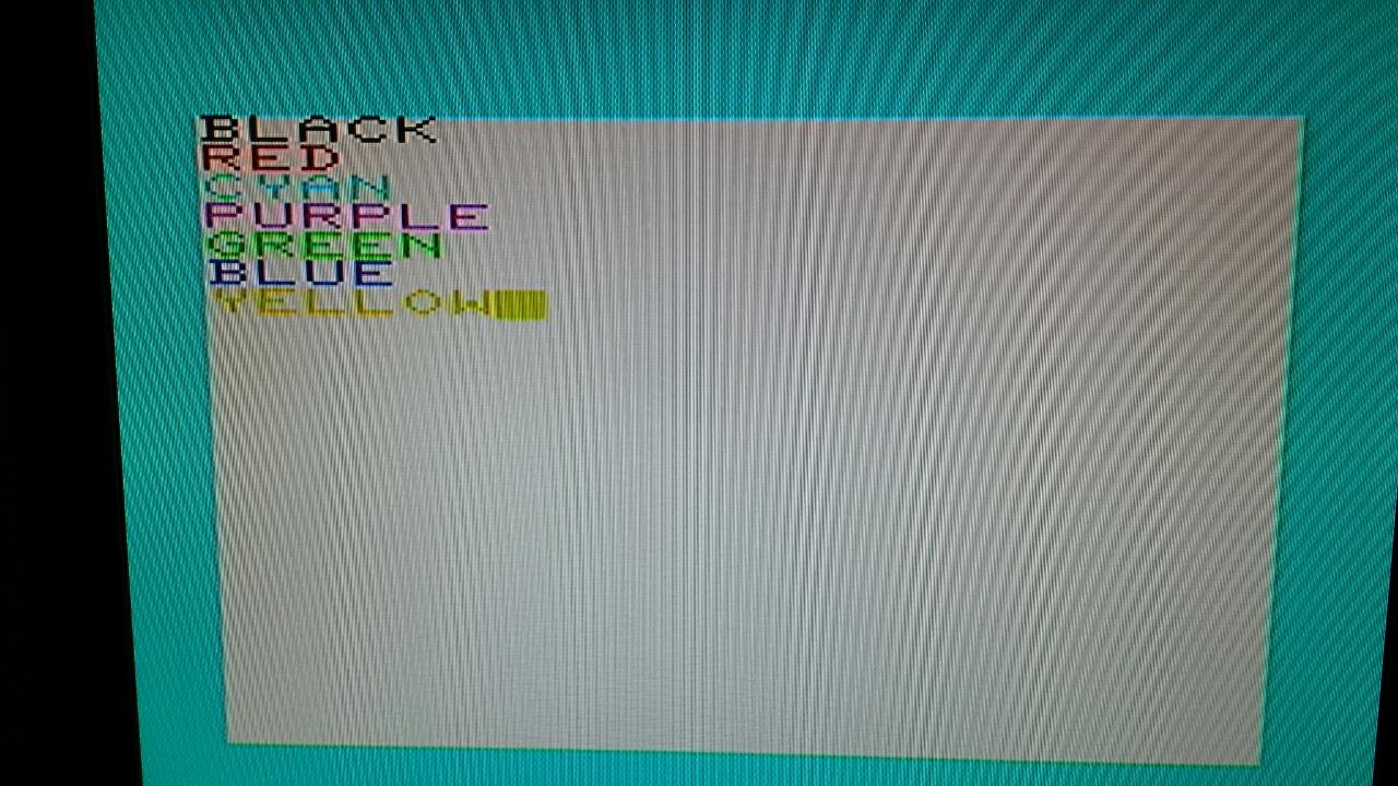

I still see a lot of dot crawl.
For your mod to be effective, the chroma signal must no longer make it to the board of the VIC-20. Did you cut that pin on your 2nd socket?

Yes. The pin is cut on the socket for pin 2. With the DuPont pin disconnected the image is 100% black and white. Maybe just my phone, but IRL the difference is like night and day.
Before
After
Before
After

I did another machine. This time I used 360 ohm and not 75 ohm like before.

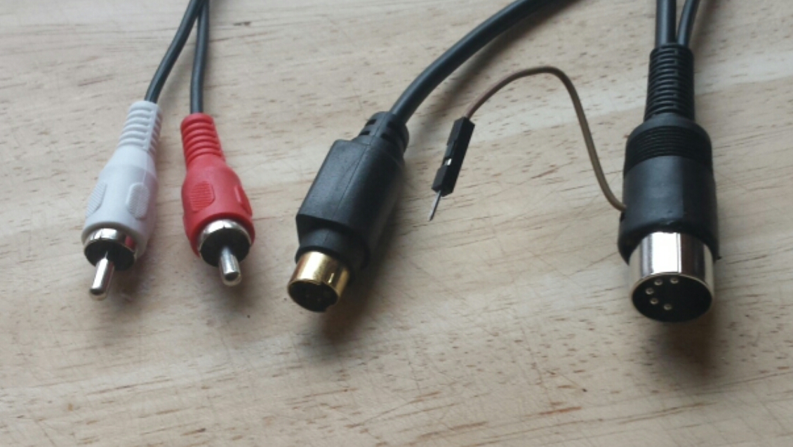

Can you show the other end of the modded cable (the bits that connect to your tv).

If your vic-i is socketed then no issue. I will supply the bits. I can make your cable up to 5 long. This is how mine looks...

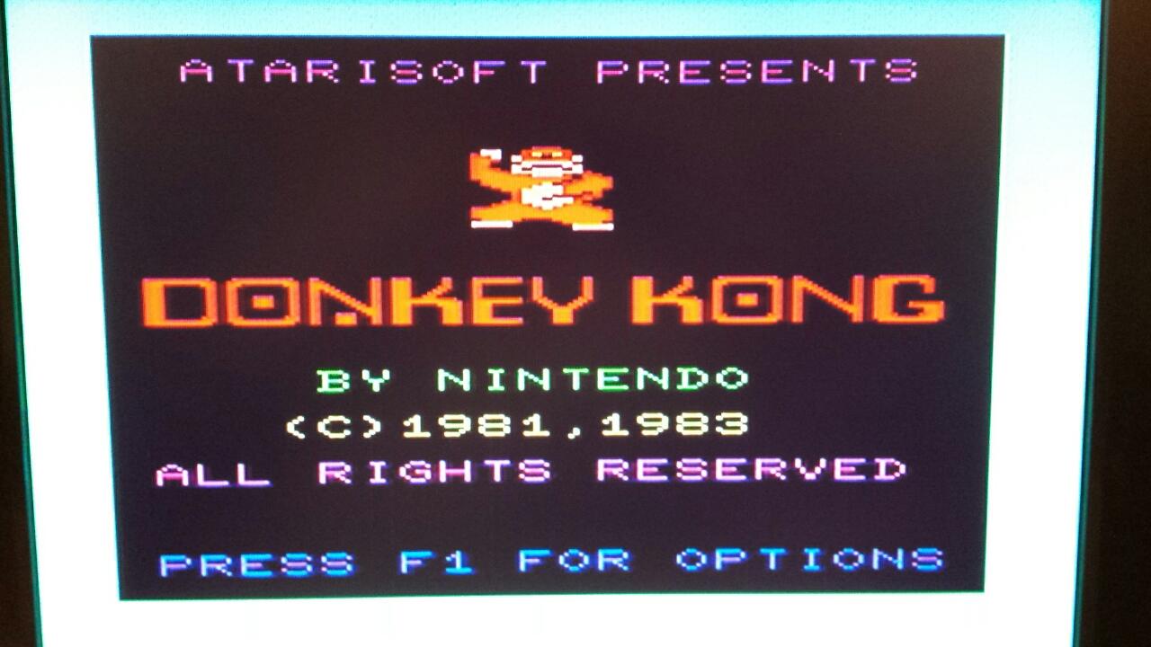

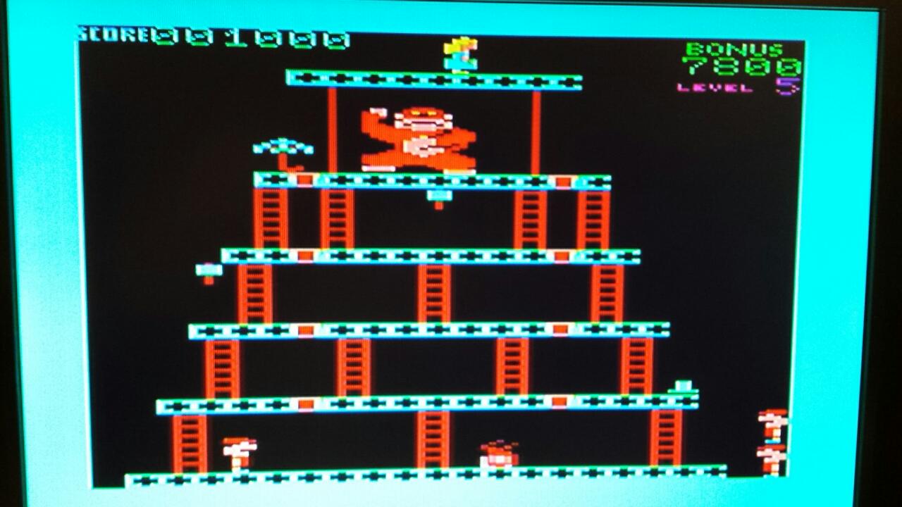

The moiré pattern confused me on your first photos.
The last shots with Donkey Kong seem just perfect.

Your custom cable for both hard mod and plug'n'play mod will look like this.
For vic20 cr with hard mod you simply connect the 2 dupont 1p on the 5pin din. For the vic20 with the plug'n'play mod you connect the dupont from the vic-I to the cable. Job done.
