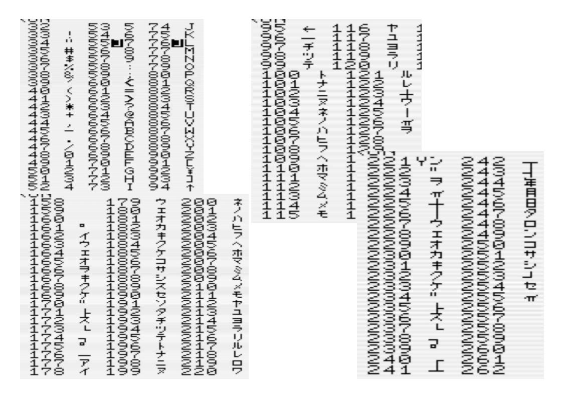

I've been working on typing up a program for the VIC-1001 so have needed to check the katakana character mapping. There are definitely some corrections needed. Don't have time tonight to list them but you can use this montage to make corrections

Yes! Thank you for reminding me to go back to that part and make corrections. I followed your pic.
