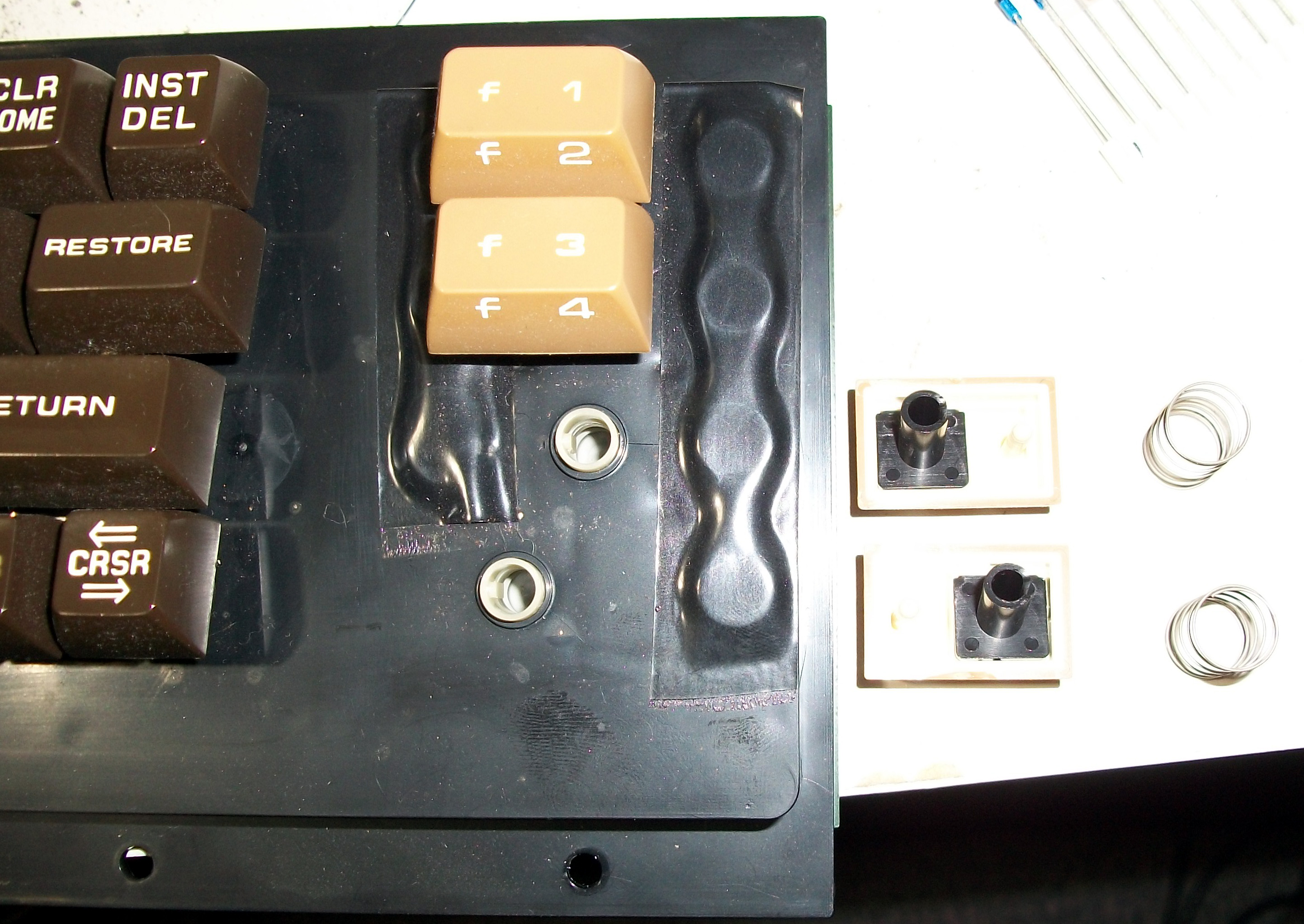

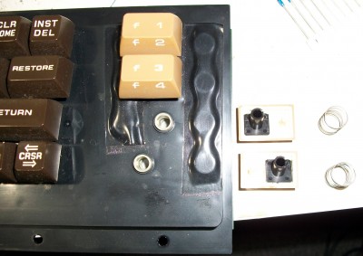

The underside of the repaired PCB:
The problem with the F7/F8 key:
Note the bump on the left side of each white plunger and the corresponding slot in the black stalks. The stalk of the F7/F8 key fits on backwards compared to the other keys (which also messes up the angle of the key), and the white plungers only fit in one way around. I did notice that the plunger for the spacebar fits in either way round - I'm not sure if that's relevant to my problem or not (I simply fitted it facing the same way as all the others).
I didn't have any black electrical tape, as you can see. Once it's all put together you can't see the blue tape anyway so it doesn't matter, as long as it keeps dust from entering.

Analyzing the last pic too I can see an insert-key on black piston and in the gray socket, but for F7 the insert-key is reversed, so it will be necessary rotate of 180° the gray socket or to extract the black piston from the cap-key, rotate it of 180° and refit it inside the cap

Thanks for your patient suggestions MCes, but unfortunately I can't do either of those things. I can't rotate those parts by 180 degrees because they only fit one way round.

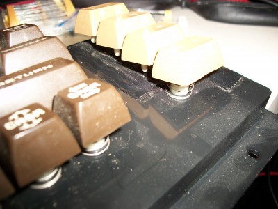

As promised...
FriedOrange79 wrote:Note the bump on the left side of each white plunger and the corresponding slot in the black stalks. The stalk of the F7/F8 key fits on backwards compared to the other keys (which also messes up the angle of the key), and the white plungers only fit in one way around. I did notice that the plunger for the spacebar fits in either way round - I'm not sure if that's relevant to my problem or not (I simply fitted it facing the same way as all the others).
The slot in the black stalk is on the opposite side in my keyboard.
I'd say one of your plungers is misplaced.
