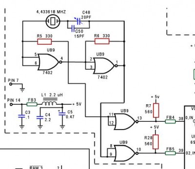

Posts: 1342
Re: Display issue
Thanks for this schematic, it confirms I'm adjusting the correct component. The joints looked a bit suspect, there was some flux that suggests someone may have replaced it. I've redone them but it doesn't change anything.
Should there be a physical stop on this? It seems to rotate in both directions without end. I only have a (metal) watchmakers screwdriver that fits which causes all sorts of distortion if I try to adjust while powered on.

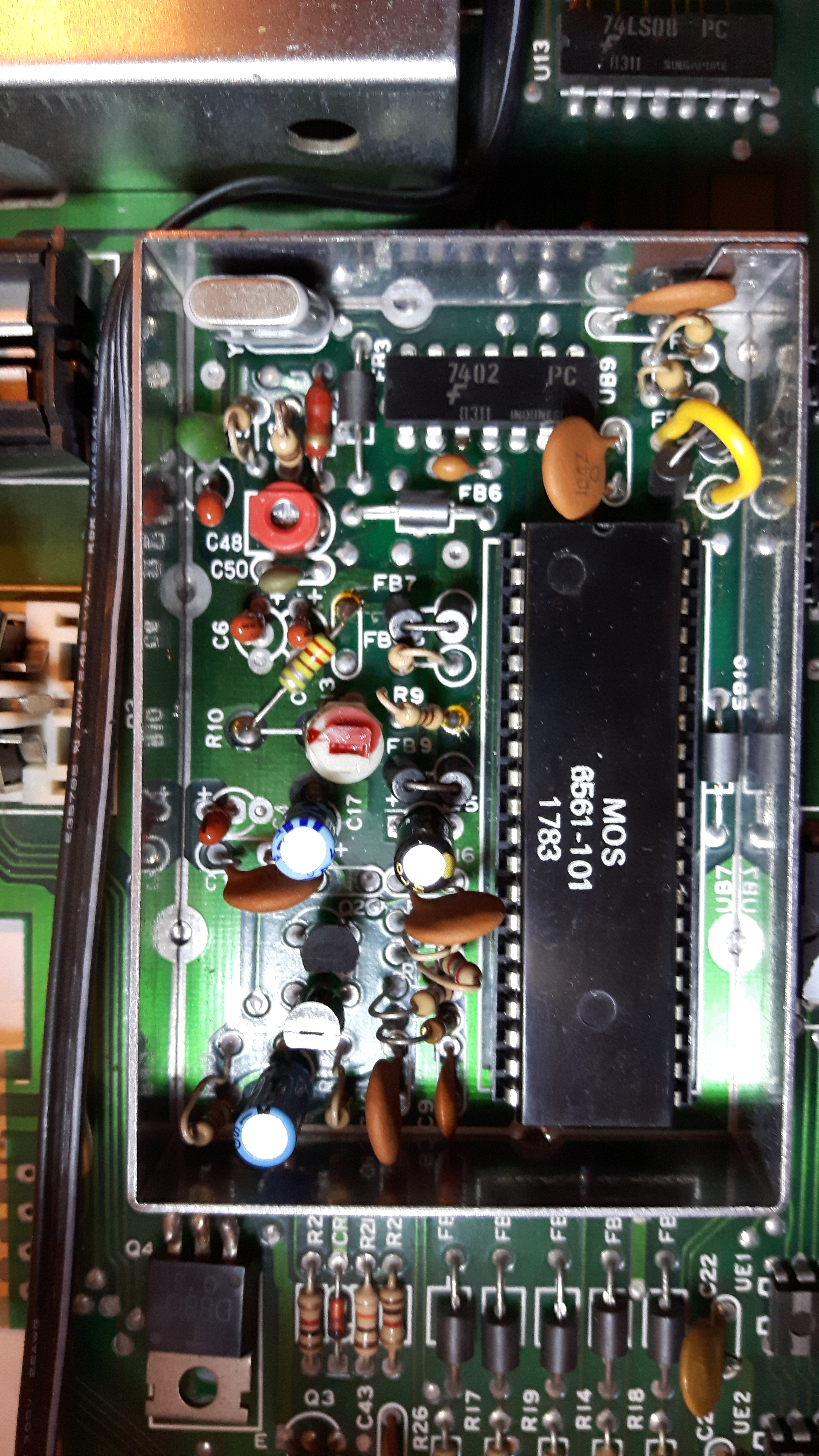

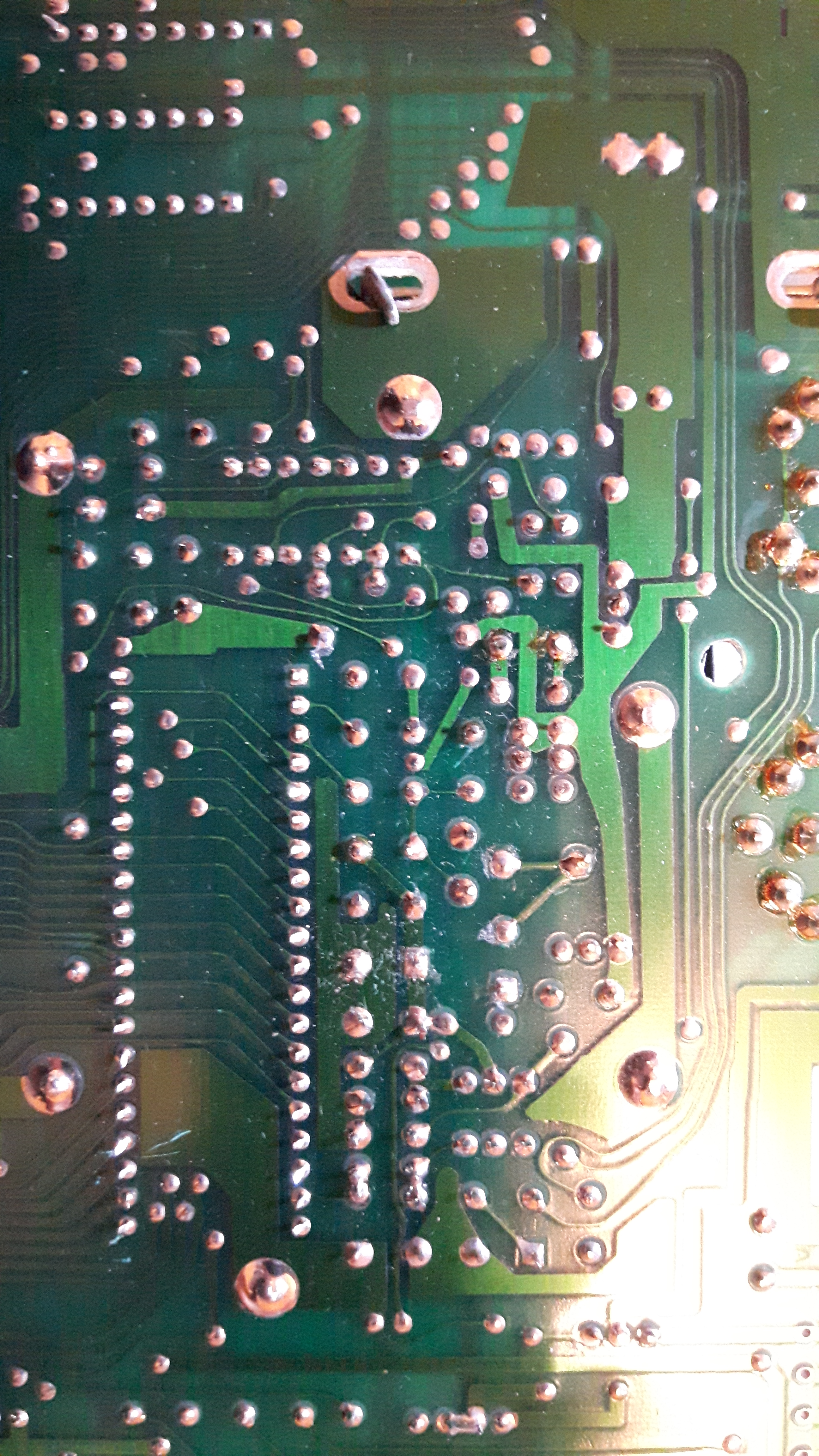

Post some pics of front and rear of PCB (the shielded part).
Read on Xtal surface: is it writed "4.43......" or "8.86....."?
The 56pF capacitor has to be soldered electrically in parallel to R5 (@ 4.43 MHz Xtal)
Posts: 1342
Re: Display issue
Here are pictures of the front and rear of the PCB
The crystal is 4.433618, there's no sign of a capacitor being soldered to the rear. Shall I try adding one, it's just a standard ceramic?

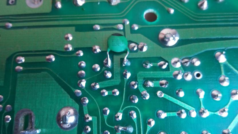

Posts: 1342
Re: Display issue
Actually looking at R5 under a magnifying glass it looks like the green capacitor next to it is in the same holes as the resistor. I can't see any markings on the capacitor.
