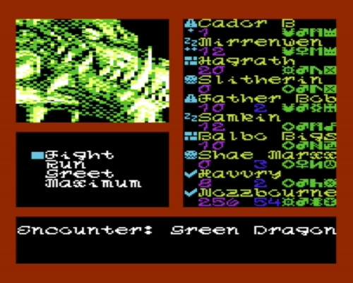

Pic of the day:

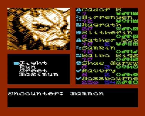

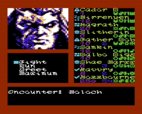

R'zo wrote:If you decide you need an artist I can recommend someone who is great at this sort of thing but i am sure would love to do it as well.
I spend about 60-90 minutes a day to produce about 4 monster images. I have .bat files that facilitates this process which opens 3 instances of xvic, GIMP and 2 folders along with NotePad++ from where I'll do my work. I almost have it down to doing this in an assembly line fashion. I source an image from Google images (example I search for "Kobold D&D"), find an image that I like, play around with the brightness-contrast levels, resize it down to 44*88 grayscale, export it to PGM format. Then use PGM IMPORT to convert it to MG format, then try various colors until I get something that I like or is at least presentable. I then output the memory contents of the image to a .txt file by "printing" the values from VICE, remove excess spacing and the like, copy-paste it into a source code file, modify the compile script, compile all the source code to integrate the new image(s) into the game files and then view the finished results into the game running on an emulator.
I've done about 140 total images now (which is getting pretty close to about half of the graphical content of the game). I'm certain that there are people out there who could produce far better graphics than I could. The main reason why I'm taking this part of the game production myself is because I want a huge number of graphic images. And I'd hate to tell somebody: "Hey, I need all of the 139 monster image portraits completed so I can start working on the combat engine as soon as possible". It would have definitely been easier to delegate this part of the game to somebody else for sure (and the results would have been better) while just being happy with using placeholders while I chomped away working on the combat engine (I haven't touched any real programming on the game for a few weeks now, I've probably already forgotten how much of my game engine works now).
Thank you very much for offering to find a graphic artist -- I think I'll just keep doing the graphics work. It comes down to quality vs quantity -- I've chosen the emphasize the latter while sacrificing a little bit of the former.

eslapion wrote:It is perfectly possible to have the Behr-Bonz hardware present 256 windows of 8k each visible at the BLK5 area and leave 24k of RAM expansion (for the game engine) at BLK 1, 2 and 3.
The added benefit is if you disable the game, the cartridge becomes a standard 24k RAM expansion.
Let's say we have BLK 5 to be the Window that can have data loaded from the BB cartridge.
Now, I am using BLK 5 to store miscellaneous game data like the current map the player is exploring. It's easy enough to have the BB switch to an 8K window that stores the world map, a city map, the floor of a dungeon, etc. As all of these will occupy 8KB of memory.
But when combat occurs, BLK 5 needs to be populated with:
1. 5KB combat module
2. 1KB monster image #1 (actually 1003 bytes to be technical about it) -- could be one of any 139 images
3. 1KB monster image #2 (1003 bytes) -- ibid
4. 1KB monster image #3 (1003 bytes) -- ibid
Is it possible to use BLK 5 as RAM to load the combat module and 3 randomly chosen monster images there from the BB cartridge?
EDIT: I think one could probably work around this though if BLK 5 needs to remain "ROM"-- I could just pop the 3 monster images into BLK 1 and once combat is finished, just reload the code that the monster images overwrote. It might be possible then to make this game for a modified BB cart in the end. I can't make promises about making Realms 5 for such a piece of hardware -- my highest priority is to make a disk-based and SD card version and have it published in that physical format because it is easier to do it that way. Maybe somebody could look at my source once all is said and done to see if it is feasible to do so as well.

eslapion wrote:It is possible to have RAM in the 3k expansion area too, you know. You could put you monster images there.
That would certainly work too.

I've done 112 monster portraits so far. It's getting to be a lot of fun to be creating those images for the much more powerful ones.

The shading came out very nice on that one.
How many pics do you have left?
