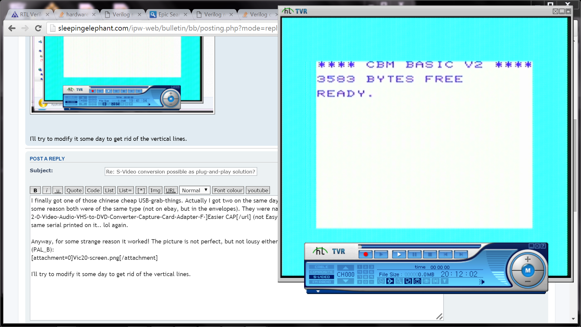

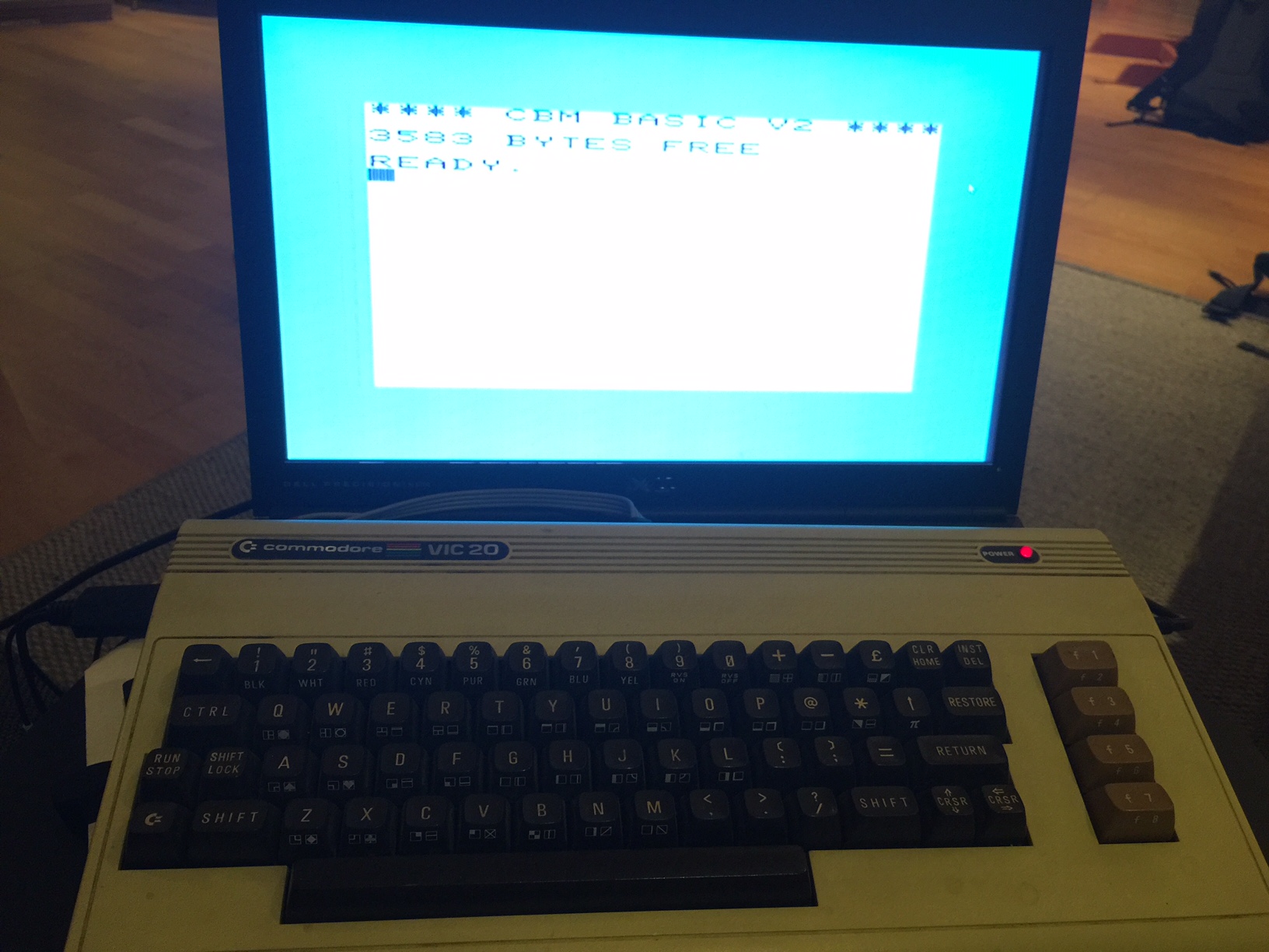

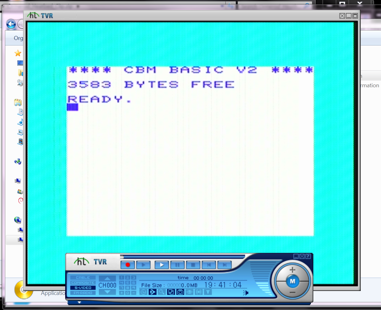

I finally got one of those chinese cheap USB-grab-things. Actually I got two on the same day (strange since the delivery was specified as 3-8 weeks). For some reason both were of the same type (not on ebay, but in the envelopes). They were named Easier CAP (not EasyCap.. lol). And they both had the same mini-CD with the same serial printed on it.. lol again.
Anyway, for some strange reason it worked! The picture is not perfect, but not lousy either. I haven't modified the output, its a standard Vic-20 output (PAL_B):
I'll try to modify it some day to get rid of the vertical lines. In fact, increasing contrast reduced the appearance of lines on the white background:
Very nice! A portable Vic-20 is the way to go. I call it my Dell Precision VIC20: :mrgreen:
