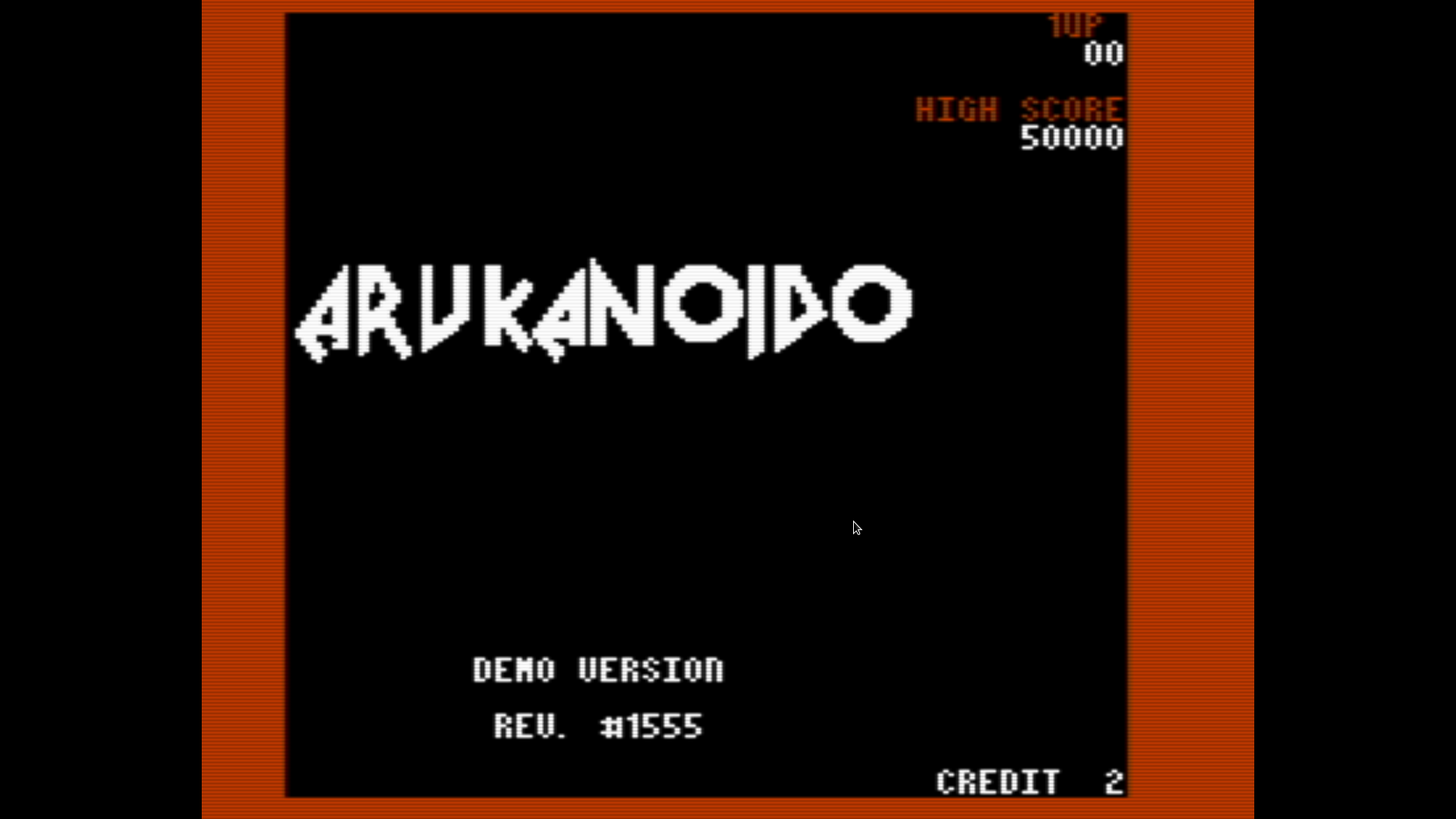

Added graphics courtesy of darkatx and updated the credit pages.
arukanoido.demo.1555.zip
(658.36 KiB) Downloaded 111 times
