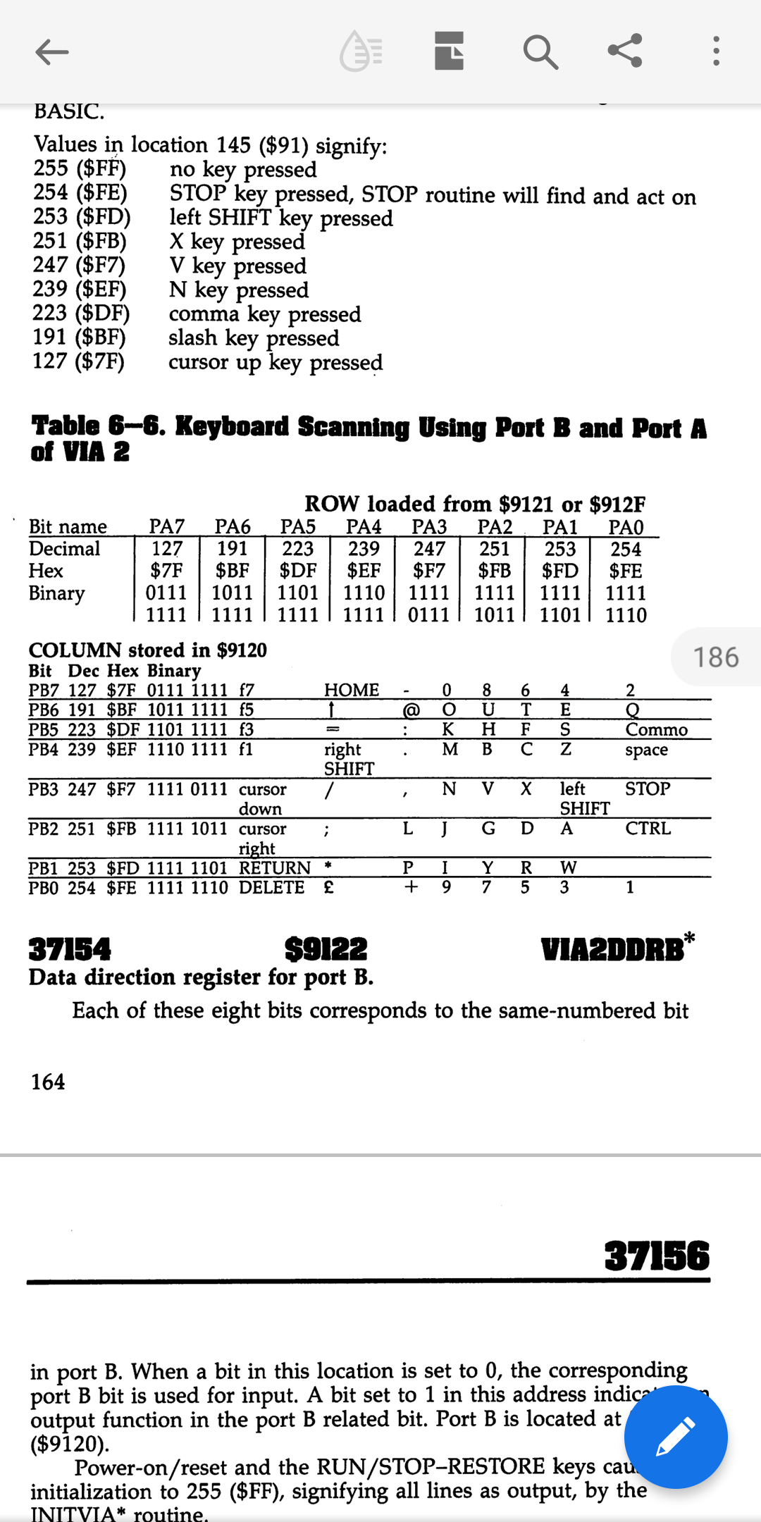

I've been working on a way to get multiple simultaneous keypresses from the key board input and I found it.
$9120 and $9121 are used to scan the key board. $9120 sets which column is to be scanned. $9121 returns the rows on of the column being scanned as 1 bit per row. There are other registers that are needed to set up the keyboard scan but this routine wedges right into the scnkey routine and lets the kernal do all the dirty work. The bytes returned from the column scan are represented as 8 characters on the top left corner of the screen.
Retrieving the individual keypresses from these bytes would differ depending on use (whether or not you want every individual key, the first key from each row, the first key from each column etc.) Each key is referenced by column bit by row bit. I.e... In the demo (screen character 0 bit 7)=row 8 column 8. Computes mapping the Vic has a table representing on page 164.
Just imagine getting parallel input from separate rows or columns or diagonal movement from awsd controls!

Phantom keys are definetely a problem... (it should be common knowledge too). Depending on what keys you press, there will be shortcuts in the matrix and extra keys detected, for example if you press 3 keys that are in an "L shape" in the matrix. The only way to prevent this from happening is putting extra diodes into the keyboard (which wasnt done in the vic20 and c64 to reduce cost).

So this would mean that if you build a keyboard yourself, all you need to do is connect the diodes to make it work.
What kind of diodes would it have to be?
Posts: 5130
Re: MULTIPLE KEY INPUT
groepaz wrote:The only way to prevent this from happening is putting extra diodes into the keyboard (which wasnt done in the vic20 and c64 to reduce cost).
Noizer wrote:[... so] all you need to do is connect the diodes to make it work[?].
To decouple the matrix, each key contact needs to have a diode put in series, on the keyboard PCB. 64 diodes in total (the RESTORE key does not need one).
Preferably, Schottky diodes.

Phantom keys are absolutely real. They don't appear in vice but vice only seems to accept 6 keys at a time.
This still has it's uses. A,S and W are on the same row while A and D are on the same column. These can be used together as long as you don't need to detect R or F since they can appear if W or S are pressed with A and D. Pressing R or F with A and D would produce W or S as phantoms as well.

R'zo wrote:They don't appear in vice but vice only seems to accept 6 keys at a time.
That could be a restriction of your PC keyboard, not necessarily of VICE. The keyboard I am currently typing on also does not anymore recognize "J" when I type and hold "A", "S", "D", "F", "G", "H" in quick succession, in Notepad. More expensive "gaming" keyboards do however recognize an arbitrary number of keys.
BTW - the phantom keys should appear in VICE. ;)
groepaz
Posts: 1265
Post by groepaz »
yes, they do appear in vice. and the limitations of the pc keyboard are also very real :)

Mike wrote: Thu Sep 16, 2021 7:13 am
Good news, it works!!! I was able to create a 8x8 button Matrix where every singel button can be combined with any other. No more collision / bitclashing. I will post some pics later and the "driver" code.
Got some funny shapes like smilies etc. Primary purpose now clearer. I do imagine something like a "touch screen" for vic 20 for painting apps or some efficient sound tracker controller even for games.
